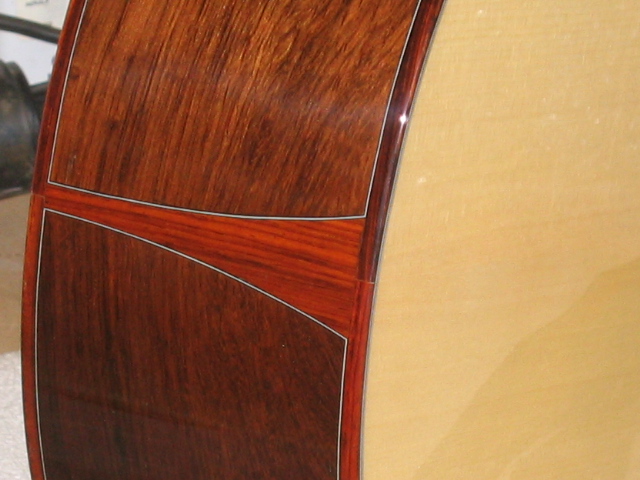

Hmmm, I thought I'd made a page up when I had done a similar job once, and sure enough, I found it!
     The page is here.
This was the prototype OM/D model, which had been hacked up pretty good in testing(which included having 3 pickups installed at the same time for a pickup test/shootout), but in the end, it was too good a player to chop up and burn, so I fixed some cosmetics, and sold it.

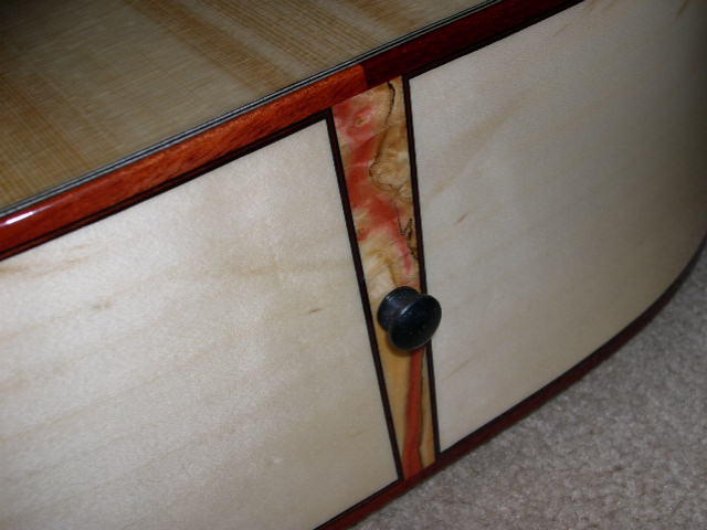

Oh yes, here's a wedge, courtesy of BobC:
Steve Kinnaird38876.5922800926

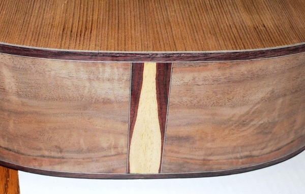

Yes, that cheveron pattern, it is really easy. Just take a piece of nice straight grained wood and cut it corner to corner. Flip one side and joint it. Glue it up then cut your wedge out of it.
They come out looking like this:
(but you might not want to install it going the wrong way, like I did.    )
Brock Poling38876.6320949074

That wood is an offcut from a piece of spalted Ambrosia maple. The bulk of this formed the rosette. I'm 99.9% certain that this is Boxelder. Other "Ambrosia maple" on the market--which isn't Boxelder--turns a brownish shade when attacked by the bugs. Not that bright shade of red.
Glad you guys like it...thanks.

Brock--I really like your chevroned (word?) wedge. Only--why did you use a spruce back?

Yes, the wider part is near the top. Don't follow my example. That one is in backwards.
Steve.... I was trying something new. I thought the back of that guitar was just too pretty to hide so I made it the top.

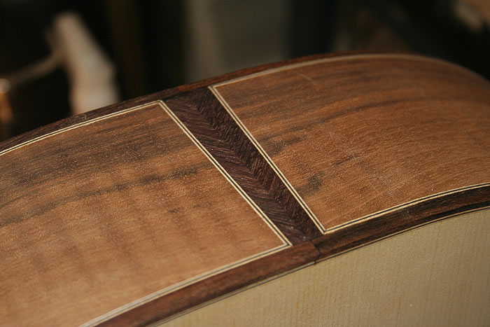

[QUOTE=KiwiCraig] All these wedges look fantastic . I'm very impressed with you combo Paul. I know we spoke of it ,but seeing it in the flesh is a different thing all together. Your work looks very neat too! , as is Dave's and Alain's. Looking forward to seeing it all complete .
Cheers ! KiwiCraig[/QUOTE]
Thanks Kiwi, that is the endgraft that fought me all the way, huge gaps between the binding and the graft. Had to re-do, fiddle, and fuss with the rotten thing. Though I'm happy with the (eventual) recovery. Oh, and the true color of the blackwood hasn't come out in the pic - it looks faded, it's much more golden when seen in person, much less contrast with the binding. You can just see some of the back in the pic, the sides look more like that.

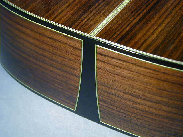

I've done endgrafts as either wedges or straight. I find the wedges to be easier because, well, they're wedges. Straight endgrafts have to be exactly the right dimensions or you get gaps as you can see in one of the following photos:
I had to fill a few small gaps in the top photo. The one in the bottom photo required a wider endgraft as a result of the sides not being bent quite right. Rather than rebend both, I just cut them for a slightly wider endgraft. I didn't want to do a wedge on that guitar. But since the back doesn't have a center strip, I don't think the wider endgraft takes away from the look.
